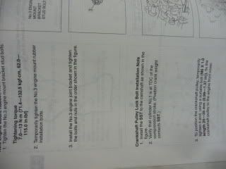

I have a digital copy of the manual...I can take some screen shots for you.

Here are a few pics i took really quick but i can take better ones if these dont work right... took them in a hurry as i need to get home.. Hour drive from shop

haha its too small. thanks anyway
