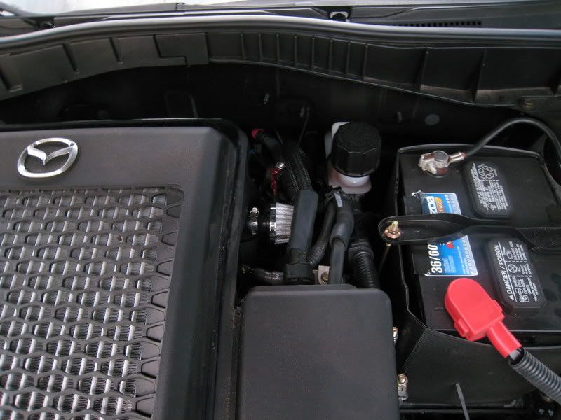

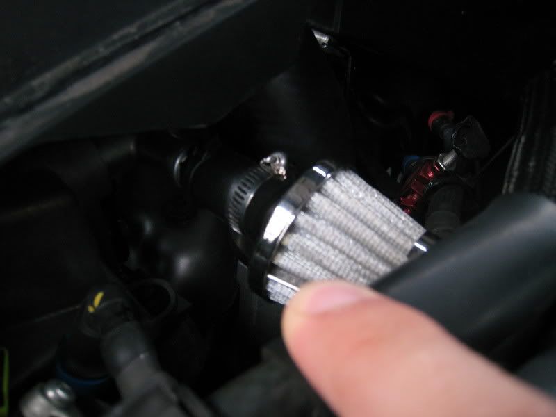

2 days ago I purchased a crank case vent from Auto Zone. The part cost about $8. The installation took about 5 minutes. I used the vac hose coming off of my Fujita CAI to assist with the installation. I cut the hose up so the filter would fit to the vent on the engine head. I also used the hose to place a metal slug into to keep the intake hole plugged. I used the hose to plug it so I could use a wide object that would never get sucked into the intake.
I repeated the steps that lead to my car smoking:
1. Get off work at 5:00 PM (Florida heat and humidity are at 90 degrees and 75%, respectively)
2. Start car with A/C on
3. Idle for a few minutes
(smoke starts to eek out of rear, visible in mirrors)
4. Blip throttle
(smoke is embarrassing upon blipping the throttle)
5. Drive away, experiencing smoke for the next 2 or 3 traffic lights.
Well, for the past two days since I've installed the crank case vent, there has been zero smoke. The only smoke was after I installed the vent and then idled the car for 5 minutes. It produced a minimal amount for about 2 minutes and stopped.
I'm a happy customer, so far. I'll keep everyone updated.
It should be noted that the vacuum hose I cut up had a small amount of oil/fuel residue in it. It clearly had that smell, too.
Misc. info that may be needed:
Mods: Fujita CAI, TXS race pipe, MBC @ 17psi, ATP fuel-cut defender, crushed 1G DSM BOV and AWR 70dm MM.
Car has 8k miles on it as of today.
Early build
Mobil 1 10w-30 changed at 5.5k miles
OEM Mazda oil filter
Pics:

woa woa woa, don't take all the credit...I actually had this done before you :p Also I was going to say that either Autozone or Advanced Auto Parts actually sells in their little help section large end caps that fit perfectly over the little pipe on the fujita intake...thats how my setup was on my fujita until I sold it on here when mazda freaked out about my modifications...
