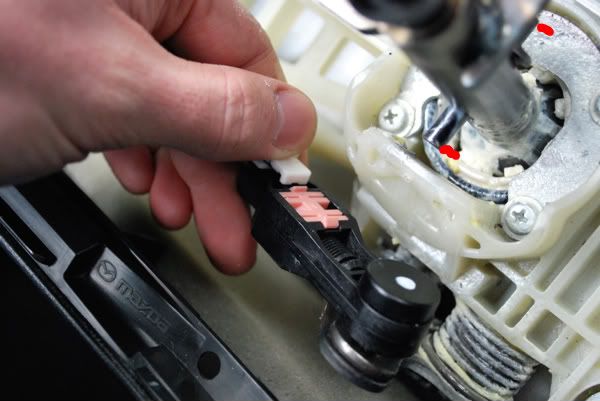

QUOTE (chiefmg @ Dec 21 2009, 06:53 PM) index.php?act=findpost&pid=1624519
Probably need to adjust your shift cables. Mine is a little reluctant to go into first as well, haven't really thought much about it but a recent development on a shift plate for our cars shows that it might need adjusting when you change from the stock shifter.[/b]
Is this done where my hand is in the picture? I also don't know how I would adjust the other cable since there is no adjustment. And what is this about a shift plate??

Is this done where my hand is in the picture? I also don't know how I would adjust the other cable since there is no adjustment. And what is this about a shift plate??[/b]
Sorry, just skimmed your original post and didn't see you had tried adjusting. Still you might not have done it quite right, from what I know you need to adjust both cables to get it correct. If you are a member over on 247, there is a thread in the 6 section (engine/transmission) where a guy jbarone (who has made a short shift plate for the MS3) is making one for our cars. If you go through the thread he has a video posted showing how to adjust the shift cables.

#14 ·
Thanks I pm'd him asking him a few questions.
I found out by removing the shift cable like where the stage 1 sts moves it. And putting it back on the stock point shifting is much easier now. I didn't think it would work with the shorter shifter but you can change it back to the factory spot no problems. There is still a lot of play in 1st and second gears though. I ordered the MS3 shift plate. A different guy said it would work on the ms6. So I will see if that works and how well it works at that.
