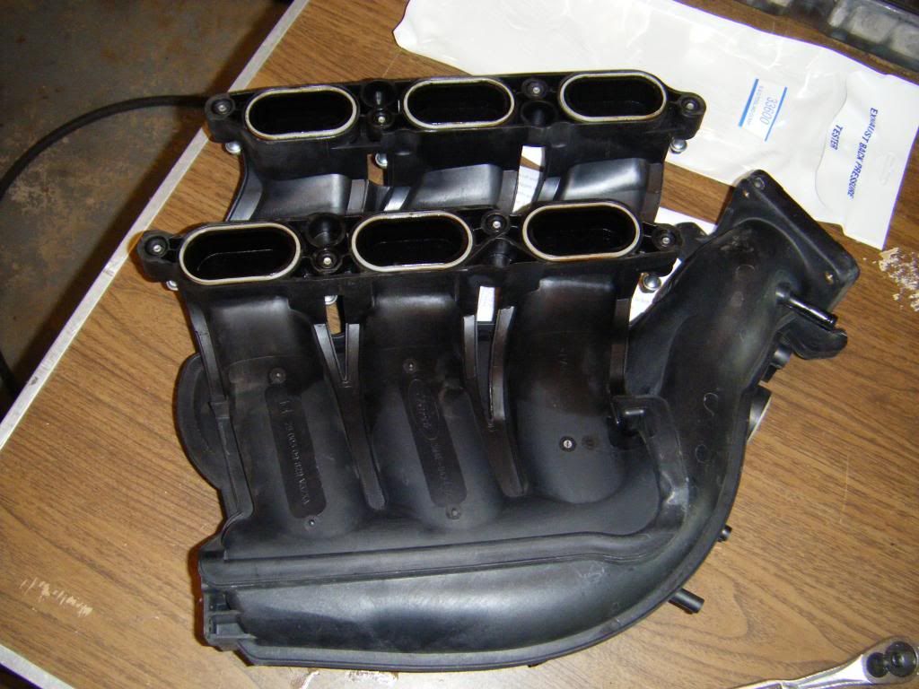

Take a look at all these ports and make sure none are snapped or cracked...
Also, I rescaned the whole thread - the O2 sensors look like crap. Not sure if thats a logging issue or what but they don't look much like a sinusuidal wave form at all.

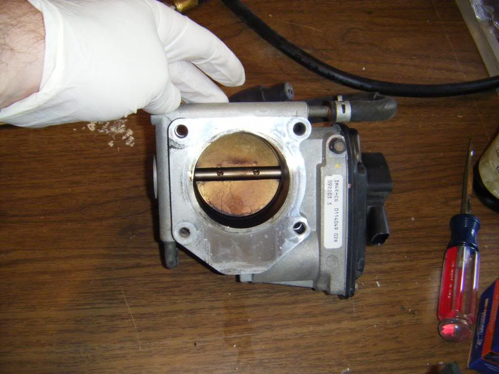

Pulled the intake this morning, and inspected it thoroughly (3rd time I have done this).
For good measure I disconnected the throttle body to have a look.
Also pulled off and inspected the EGR.. I didn't end up doing the full cleaning. Hand cycling the valve was smooth and required little effort. Could also hold pressure with the valve closed, and pass air when open.

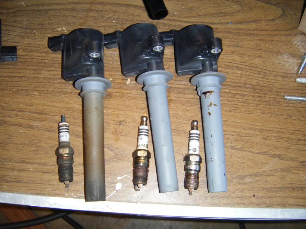

When I pulled the cylinder 1 coil pack, I noticed it was quite black.. Subsequently pulling the plug revealed that it was very scorched.
:eek:
Did I mention how anal I am?? I can almost guarantee that I checked and re-checked the torques on the plugs when I replaced them 20k ago... However, I am 42 and the memory does slip on occasion.. Replaced plugs with 6 new NGKs..

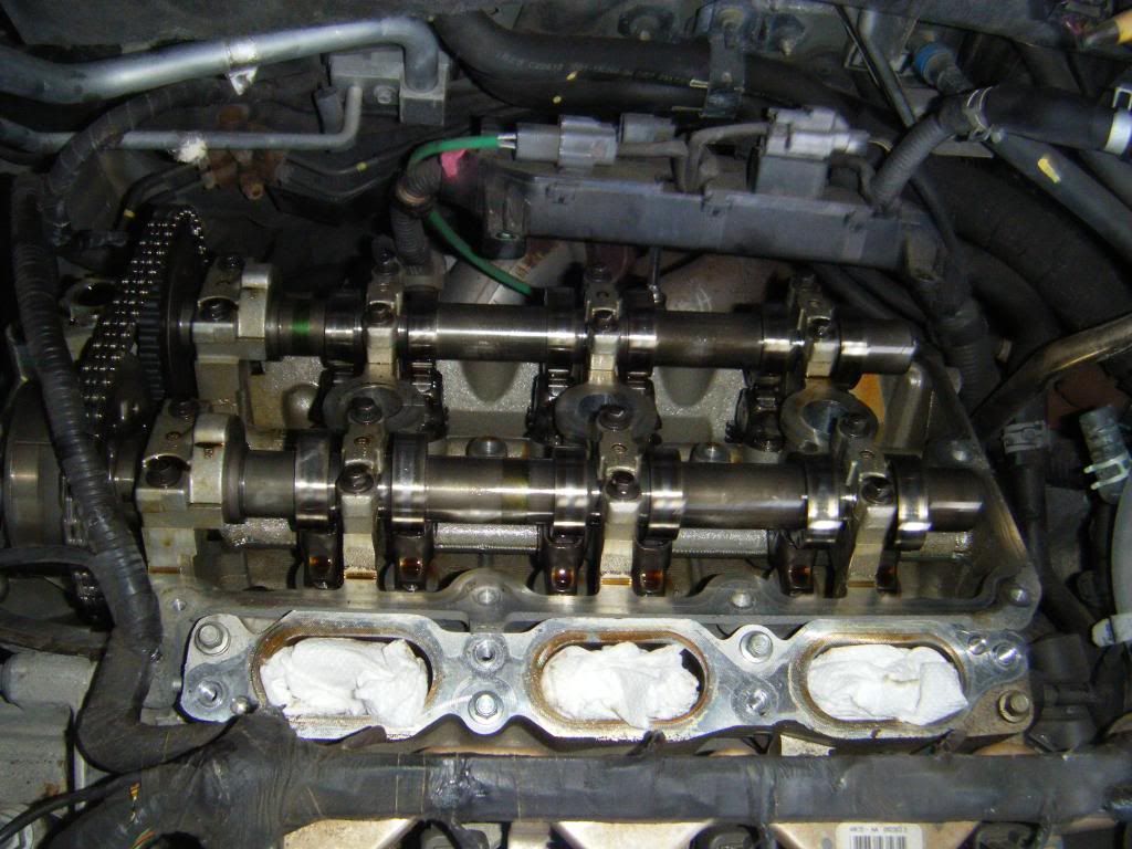

There was a bit of oil in the bottom of Cyl 2 and Cyl 3 spark plug wells. So I went ahead and replaced the head cover gasket. Had this on hand since I did the front when that was off.
Had to remove the VVT hydraulic actuator in order to remove the head cover.

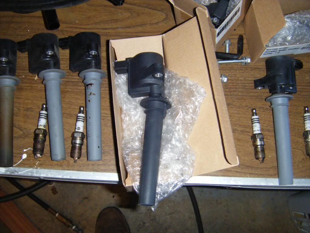

I ordered the 6 pack of CPs for $70 on Amazon.
Amazon.com: #IC23 02-07 Mazda Ignition Coil 6pcs Dg513 Uf406 Mpv Mazda 6 V6 3.0 02 03 04 05 06 07: Automotive
Did a quick continuity check, and found 5 of 6 to check out OK.. Looking at them doesn't inspire a lot of confidence (no part number, seem cheap, see in the pic how it curves?). I'm happy that they appear to work, I substituted a known good CP that I had laying around for the faulty one I received.

Looks like you made good progress. So the threads in the head were OK - no damage? That boot and plug looked nasty. AND NO MISFIRE CODE??? Oh my!! Please tell me it had P030X code! If not this explains how these things end up in the grave as crank misfire detection means nothing!!!! DEAD HOLE!!!
Anything else found along the way? A gasket out of place, Hoes off, Anything?
Points for you for digging in! I personally would of went with the Beck & Arnley units. Not more more and they have a name on them! I hope these last. Are you saying you rejected one because of the tweaked boot?
THanks for sharing...
#20 · (Edited)
Threads were black, but still looked sharp. New plug threaded in and torqued without issue. No codes!? As I mentioned, idle was good.. Must have still been firing a good bit. Top of plug was stuck in boot.
Did replace PCV valve, because I was there. Also, head cover gasket. Didn't find anything else.
Wasn't real sure this car was making it back, thus the cheap CPs. I'll keep those Beck and Arnley units in mind for future. Rejected one because where 5 of them read 10.32k ohms from primary to secondary, this one read open circuit.

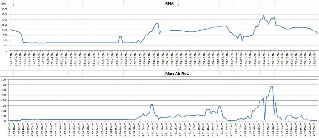

Dataset
I've been plotting some of the data in Excel.. The O2 graphs certainly don't look very smooth. I'll investigate what update rate the Torque app will tolerate, to try to smooth it out a bit.
Looking at RPM versus MAF, I'm a bit surprised that they don't follow more closely. For instance, in the dataset @ 6:52:23AM the MAF drops to 29CFM for that one reading, but the RPM was apparently steady around 3000RPM..
Thoughts? Car is running OK.
Rod
#24 ·
Another view of RPM versus MAF
Here is another view, different time period.. RPM versus MAF (CFM x 10). I multiplied the CFM x 10 to help with the scale.

Log for way home from work
I setup the logging for synchronous, so it would only log after full sweep.
At 4:58pm I got on I95 for about 3 minutes.
Seems to be running really well. Better than before the accident. Much more low end responsiveness.
Decided I better get on with replacing the passenger airbag.. Just pulled it, connectors on both sides are completely melted :mad:

Also, at the very bottom, your CAT temps go from 1400 to 300. Any clue what happened there? Looks like it was sitting at idle and maybe turned off? 26:40:02 whereby the load was at 50% parked. It all just looks strange there.
#27 ·
Under heavy load your LTFTs are still going negative. Not crazy but IMO not typical for our pig Rich 6s. So, lets say it has no vacuum leaks. I'd guess your MAF/intake combo might be under reporting the volume. IDK
The other observation is the CAT temps. Mine top out at 1280 and yours are up to 1700. Because these are calculated, I'm not sure what to make of it. That is, I'm pretty sure the sensors are not reporting the temps as they have a heater and piezo sensor. But I've always wondered if the heater circuit is being used to report the temps. IDK
Seems odd our cars have so much difference. Almost 500F.
Q? Are the tail pipe on yours sooty looking after a freeway run? Mine never clean up but the plugs look white as could be and I get 21 22 mpg mixed freeway city action. How about that one?
Thanks for sharing! I appreciate it.
#29 ·
I have a 2004 also and mine run in the 1500-1600 range on my 50 mile drive to work (mostly Interstate at 70mph crossing the Blue Ridge Mountains). I was surprised to see the "temperatures" track almost exactly the same on both and one is original and the second a replacement (270,000 miles on the original and 50,000 miles on the replacement).
Scott
