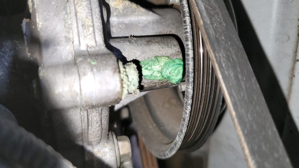

That’s quite a leak ya got there. I would most definitely replace the water pump as well as both belts and the gasket for the pump and the o-ring for the coolant tube that goes into the back of e water pump. You’ll have to remove the pulley first which may be a challenge but you’ll have to do it either through the top or through the wheel well. After that you can remove the pump itself.
