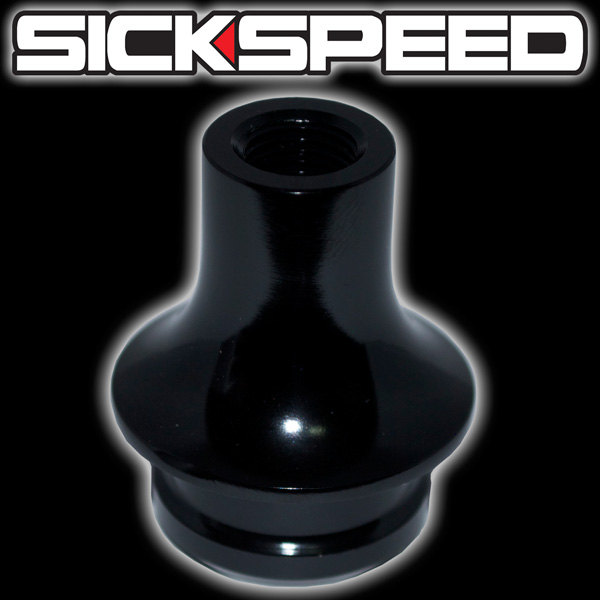

I ended up getting this:
Made some pre measurements and looks good, so...it's a buy.
$19.88 shipped (includes a Sickspeed decal) from Yakima, WA (to CA, that'll be quick)....I'll post installed pics as soon as I get it. :)
They need to make a bronze one. Would be a nice tie-in with the wheels
That's going to be too long if you're using it with the Miata knob. The gap between the bottom of the knob and the boot that needs filled is about .340" (+/- a bit depending on how far down you screw the knob)
It would work well with a knob that has threads all the way to the bottom such as a design similar to a simple round ball.
We'll, if it would...the knob would be a sliver taller then (okay). I'm more after the improved shifts (achieved that)..the top height of knob (and/or the gap below), secondary. After all, it's only $20. With or without (adjusted boot folds, as in pics)..it's fine. Options..on hand. :)

They added the spacer (the nice brace piece above) below the boot cover. Another option to go. It

Look what the cat dragged in..have 2 of these (similar to hockey puck material hard rubber) grommets, on hand. Gives new meaning to the term.."Garage Find". :D
I measured the inner diameter hole..and it's approx 0.40". With the proper trimmings...you know where this slides under. Options, indeed...;)
Well well..... Cut that off cleanly to the correct length and under the boot she goes. .350" should be about right (you can always sand it down a bit to make it shorter and/or to correct a bit if your cut is not exactly straight...)
I've been tracking the Sickspeed (it's location is now local)..and it should pretty much arrive by tomorrow. We'll see if that is a "no go"..if so, this will.

The inside arrangement looks 100% stock (pic above); no binding on the boot at all. I'm torn between that and the external, "has nice brass accent" look.
