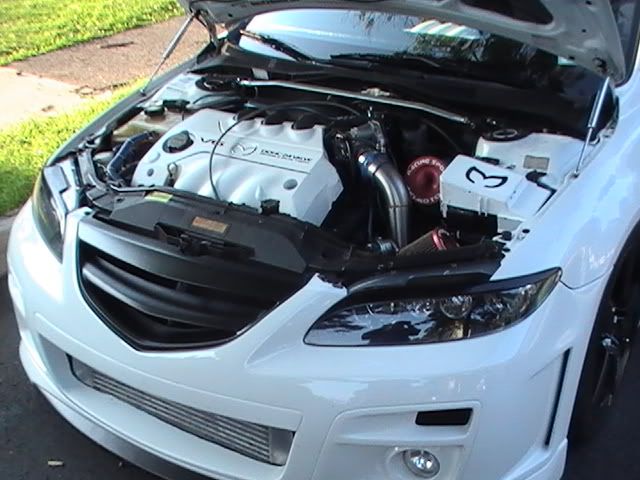

Punisher 6 is now Twin Turbo. On Her Way to a car show, just in the nick of time she is done.
new improved punisher 6 Twin'd Up and LSD'd out!!!

This is my ride. most know her as Punisher 6. i originally brought her for a DD while i built my other car. but when i totalled that other car (my escort) i started building this. and this is where we are at since i crashed my other car in 2008. i brought the 6 sometime in 2006.
2004 Mazda 6s (was a base model)
3.0L Duratec V6
Had the nasty tan/brown interior when i brought it.
Currently 102k on the ticker. Dreading hitting 100k, lol

man, i wish i had a place and time to work on my car....you are getting so much done so damn quickly! good luck with everything, gonna be a beast when it's all done.
only question is have you tried tuning the 60lb injectors already on the stock engine? i know a lot of it is the flow on the 4cyl, but i couldn't tune idle low enough with the 60's in my car. When driving i was fine, but as soon as i'd idle it would studder as it was hard to run them that low. I think my stockers were 24lb though, not sure what the 6s uses stock.
again, best of luck!
5,758 Posts
QUOTE (MrTea @ Jul 29 2009, 05:39 PM) index.php?act=findpost&pid=1586854
again, best of luck![/b]
yea man, luckily i have a backyard and jack stands, lol. as for getting done quickly. i have a show saturday. and its a very very big show, and im trying to debut my car twin'd up for that show. so thats why im working like a maniac.
as for the injectors, i never did get a chance to use them while NA, i had so much going on that i didnt get the chance to swap them. i think i will be fine. the tunner im using adjust injector Pulsewidth to change fueling. and i can tune down to 500rpms. as soon as i put them in i will be changing tunes of course and taking away 50% fuel off top across the entire table. to try and help trims stay happy and cut back the extra fuel they will be putting out.
from what the manfacturer told me, these injector s were designed to be able to run at a very low pulsewidth to help in not hindering idle. but thats all speculation of course, but we'll see when the time comes. i know my car wont be fully tuned by August 1st which is when the show is, but i just want it to the point where i can at least make it to the show and back. i dont have to boost, its a 25minute ride to the show. so as long as i can get everything installed and throw a base tune on there to get her running, i should be good until after the show where i can really start dialing her in.

if you can hold yourself back, i'd just run stock injectors to the show....don't even start with it. I'd also recommend, though not needed and i know what a bitch the rear bank can be, running cheapo plugs in the car when you start tuning. it's hard to work with the Iridiums once they get sooty, where the cheap ones you can clean up as the get covered until you get it closer...i used 2 sets of plugs when tuning my 60's (i used Siemens). And though i could adjust them however i wanted with the Haltech, it seems to be the spray pattern that didn't work as well with our manifold/flow it would seem....so no matter how i tried, they didnt' work on the stock manifold.
anyhow, my thoughts are stock injectors for the show!

well i do still have a couple old sets of my IX's that i could use instead of buying others. so i may do that. im outside now working on it, lol, trying to get the rear turbo to downpipe bolts to line up, lol
its being a PITA of course. so im on my way back out.

not sure what turbo's are being used, and i know the compression is different....but here's a Noble M12 stock Dyno
884 Posts
wow 350lb tq 350 hp as a rough estimate eh? yup...checked my pants and I'm wet.
Super Moderator
9,080 Posts
QUOTE (USAF 6S @ Jul 29 2009, 06:12 PM) index.php?act=findpost&pid=1586931
He's using 2 Turbonetics Super 60's and looking for around 400-425bhp this year.[/b]
again, not sure what the Nobel uses, but that's the same power the stock nobel hits, though it peaks at 12psi. Since it's down to 8psi when it hits peak hp, i'd imagine it will be close at least.
...by the way, i didn't notice it in the pics, but did you get that intake manifold that he had custom made as well?
