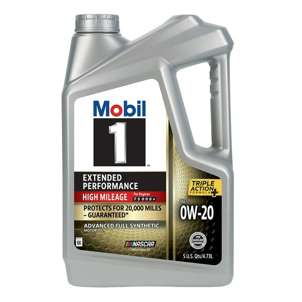

At 148,111 miles, I changed the engine oil (5 quarts):
Mobil 1 Extended Performance High Mileage Full Synthetic Motor Oil 0W-20, 5 qt

I went with the Mobile 1 oil this time instead of the usual Walmart brand Super Tech because I just couldn't find it at the two stores closest to me. I have no problem with Mobil 1 (can't say the same for Castrol) sp I just went with that.
