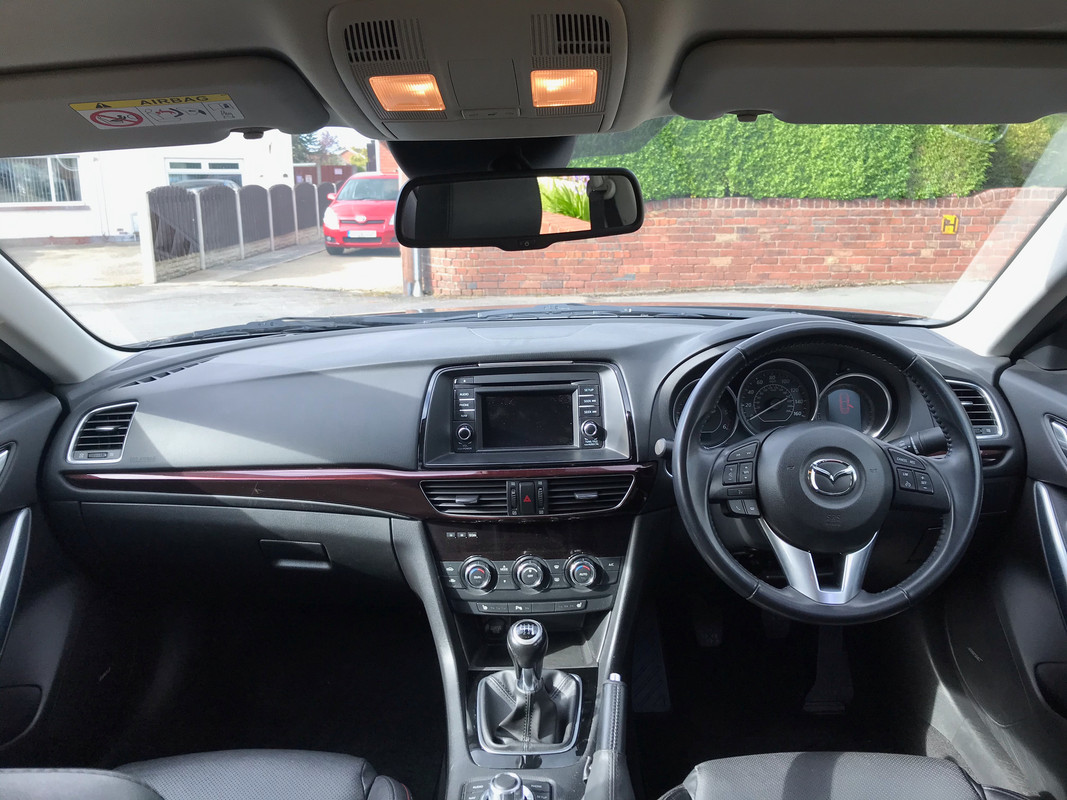

The car's interior is mint. The exterior has some minor scratches around which I will sort over time.

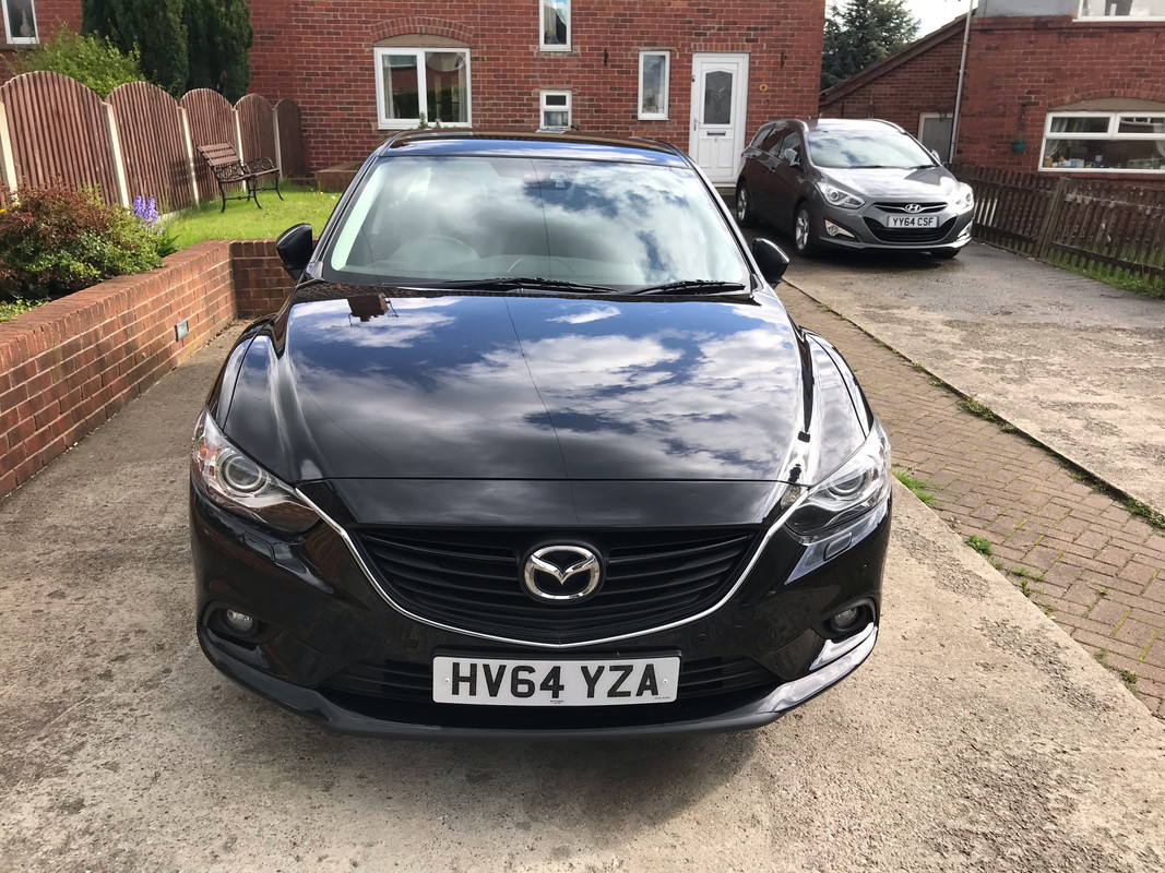

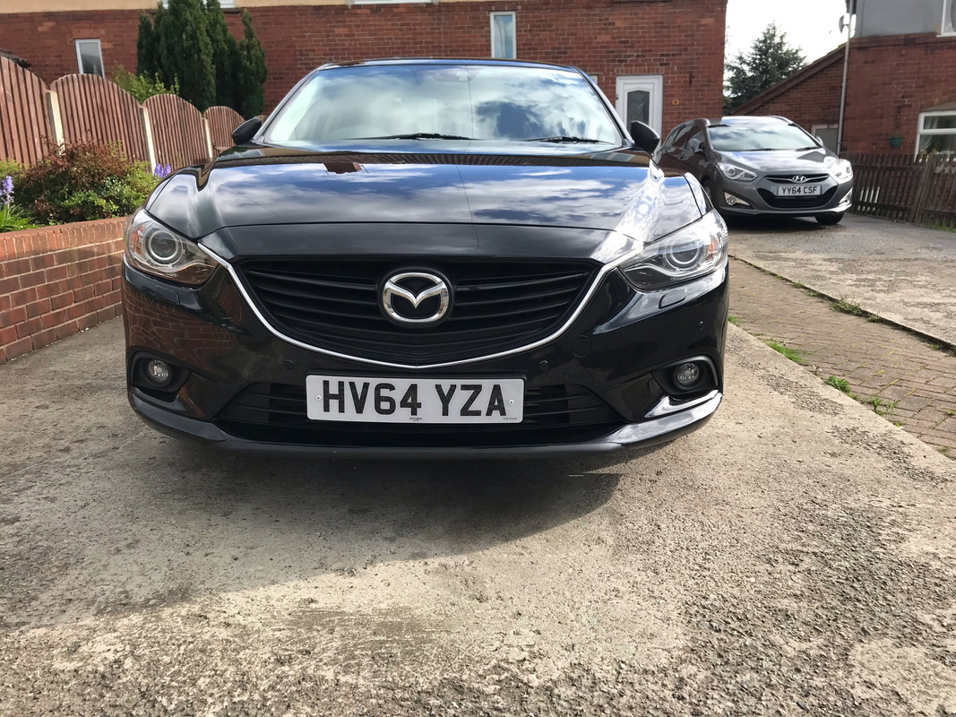

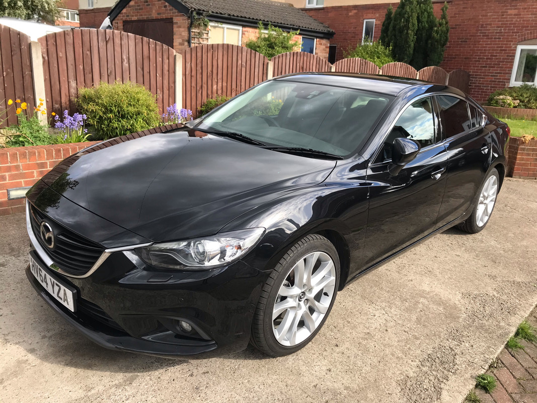

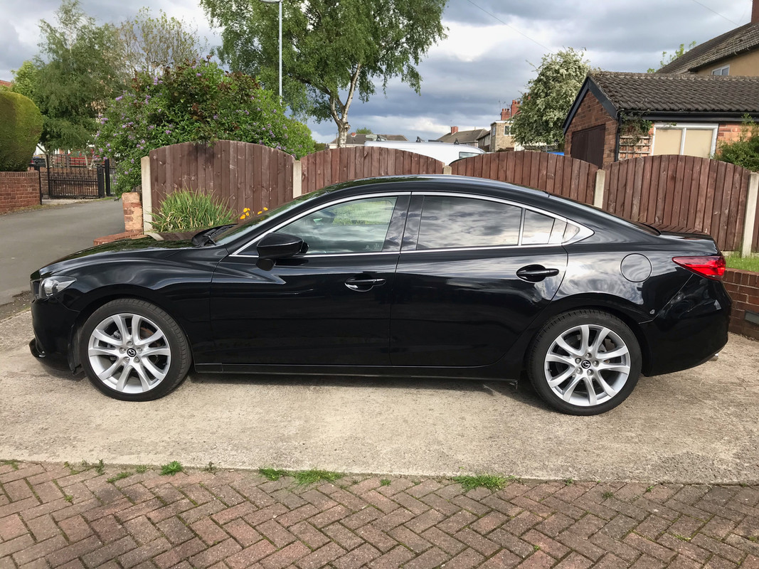

Right, some pictures of the old thing. Just washed it but really it needs a good clean, clay bar, polish and wax. I'll post some pictures once done.
This is how it stands right now.

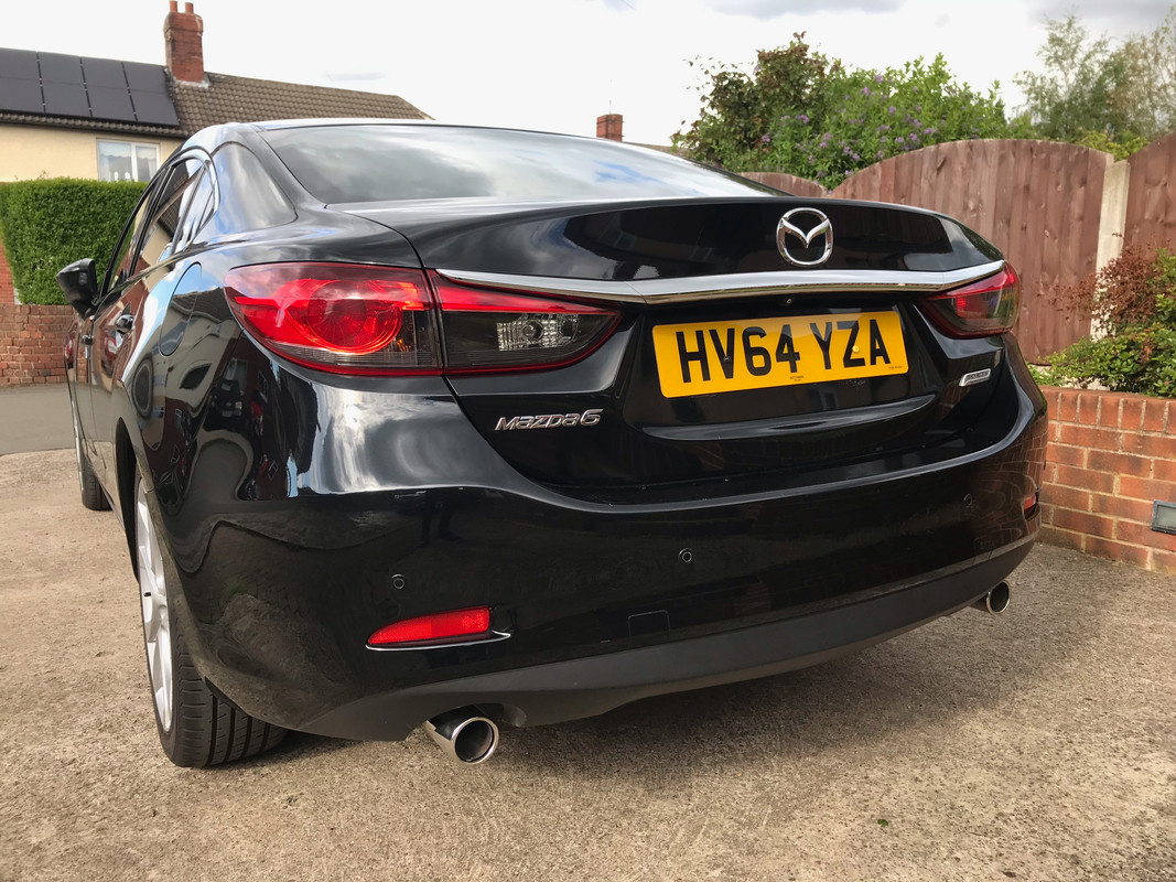

Can you please advise which of the rear lamps illuminates (or which two) when the eurospec rear fog lamps are engaged? (per this photo: IMG 8917 — Postimages)
By UK law you need to have rear fog lights. If not two then our car should have one and on the offside of the vehicle (the side where cars pass you)
UK spec Mazda 6's have the rear fog light situated where normal countries have their reverse light. Looks unsightly as you can clearly see the difference in light clusters. I'm hoping to source a EU (LHD) light cluster to change to and have two reverse lights. Then for legal purposes I'll be replacing the reflectors near the bottom of the bumper to accommodate some sort of fog light.
