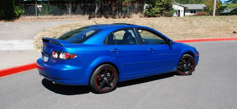

Car Year/Model: 06 Mazda6 GS HB V6 6psd
Wheel: Motegi MR116
Offset: 18 X 8 +45 Offset
Weight: unknown
Tires/Brand/Model: Federal Steel 595, 225/40/ZR18 88W
Suspension: Stock, 74,000 miles
Fenders Rolled: Not yet :/
Rubbing: Yes, in the rear when loaded and/or cornering
