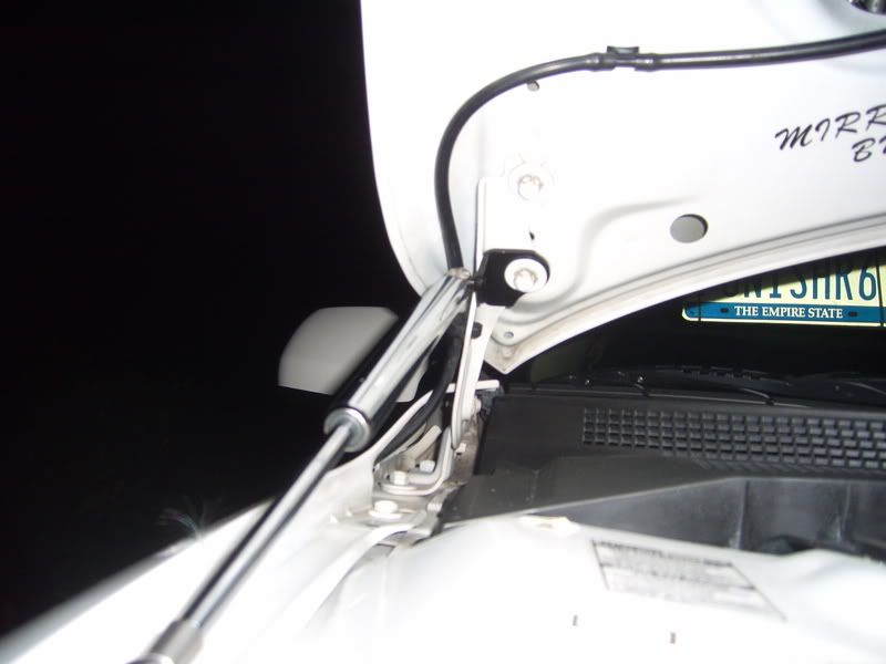

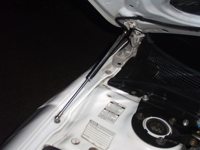

Originally the damper are supposed to be install with the shock end attached to the lower bolt of the hood hinge , and the other end to the 2nd fender bolt. look below:
Of course that doesnt work for me. So i attempted to create more leverage by bolting the shock side of the damper to the upper bolt on the hood hinge.
That didnt work.......reason being is that the base of the ball was stopping the knuckle(non-shock end) from rotating enough to attach the shock end to the upper bolt. so here's what i did.

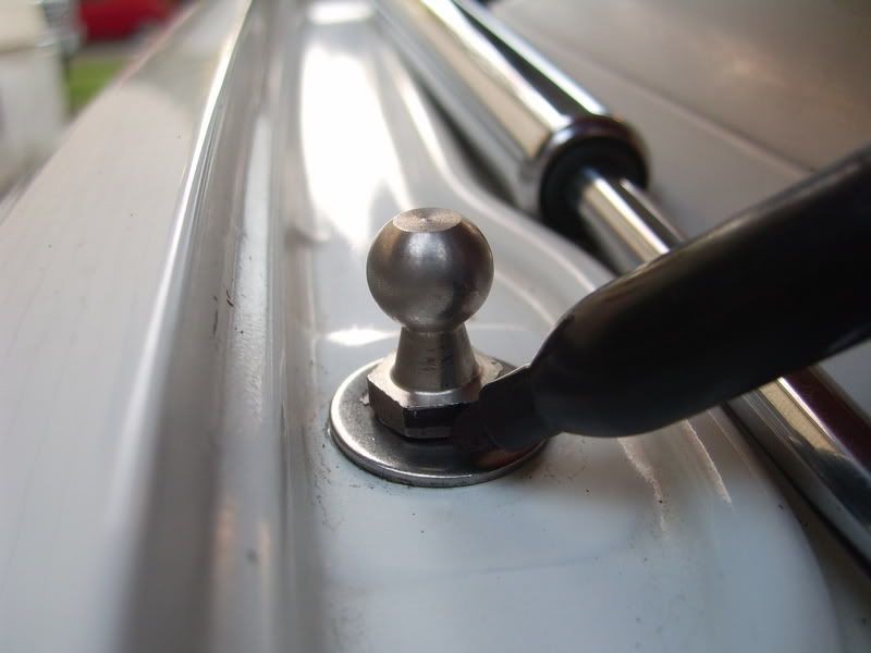

2. took a black permanent marker and marked the ball on the fenders at the point facing the front of the car.
see the mark i put below:
i did this to both ball joints.

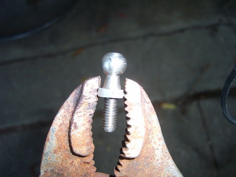

3. took my vice grip and marked the upper portion of it to let me know that the mark on the ball joints face toward that mark(so i know which way to bend the ball.
4. position the the ball joint, ball side out.......thread side in. With the edge of the ball joint bolting surface BETWEEN the teeth of the vice grip with the marked side one tooth ahead of the unmarked side(this increases the grip)
5. put the marked side of the vice grip on the ground and hold it.
6. using a torch het the ball joint until its red hot.
7. take a hammer and hit downward on the ball joint to bend it

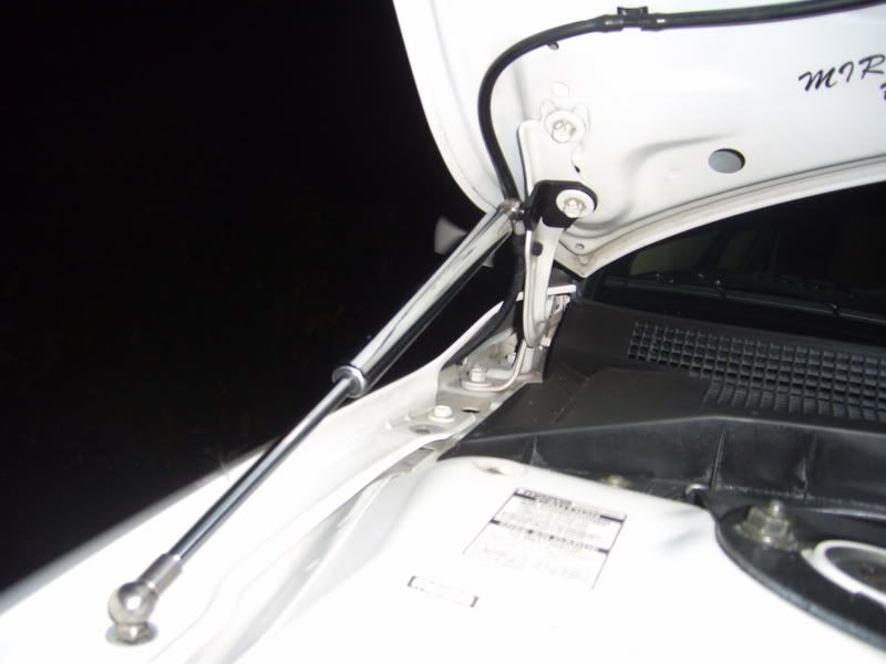

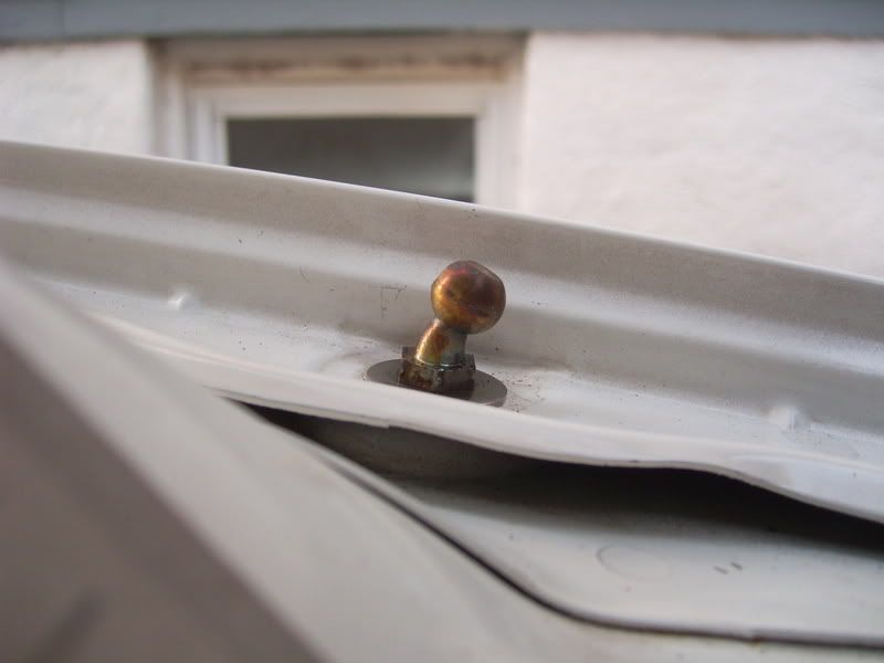

10. once cool, install the ball joints on their respective sides. you should now have a ball joint that looks like this on both sides.
11. move the dampers shock side brackets one at a time to the upper bolt of the hood hinge and tighten.
12. reinstall both dampers completely
13. put down your stock hood prop and close your hood. Your done.
***LOOK BELOW FOR FINISHED PRODUCT***
****In the event of one or both of the dampers shock side brackets turning inward toward the center of the hood. Purchase to lock washers(the type with the lock notches around the entire washer and put them on as well****
With the added weight of the mirrors on my stock hood, this mod gives the shocks more leverage therefore giving them the strength to lift the hood on their own once its almost half way open.

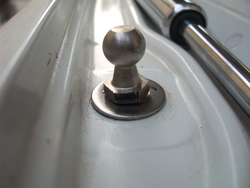

The reason this happened is that TGNY installed the hood-side brackets on the lower bolt. When the dampers are extended at that angle, there isn't enough backpressure from the dampers to support the hood, so it falls down. If you install them on the upper bolt, the dampers will support the hood just fine... no insane modification necessary. I enjoyed the videos though.
74 Posts
I was getting sick of using the hood prop rod, so I ordered me some NRG hood dampers... took about 15 mins to install, and they work great! They do bolt to the top bolt on the hood, as you can see in the picture I took of mine.
