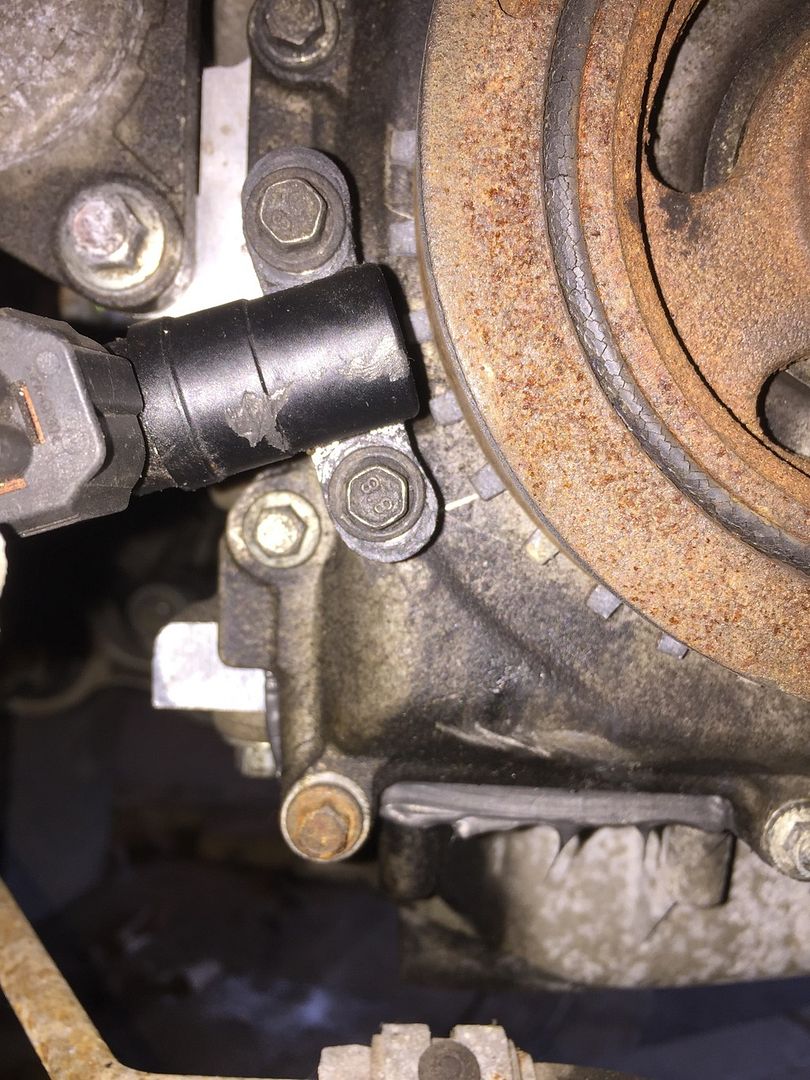

I had a chance to troubleshoot a little bit. The coil does show 12v on the center pin when the key is in the on position when I ground the multi meter black lead to the battery -. But if I just hold my red lead on the center pin and probe the other two pins with the black lead I get nothing. So I am thinking I am having a grounding problem for the coil pack. I checked the two grounds on top of the transaxle that I see and they seem to be good. Since that car that is pictured (from the happywrenching write up) is a COP car and I have just one coil pack with spark plug wires I am wondering if my wiring is a little different. There is a wire that comes out a few inches below where the coil pack is plugged in and it goes to ground. I am thinking this is probably the ground for the coil. Can anyone verify this? This ground wire in question has a little black box on the end of the wire just before the ring terminal. I'm not sure what this is. Does anyone happed to know which wire should be my ground wire going to my coil? The center wire is black/white and it gets 12volts when the ignition is switched on. The other two wires, one is white and the other is black. Does anyone have a wiring diagram?

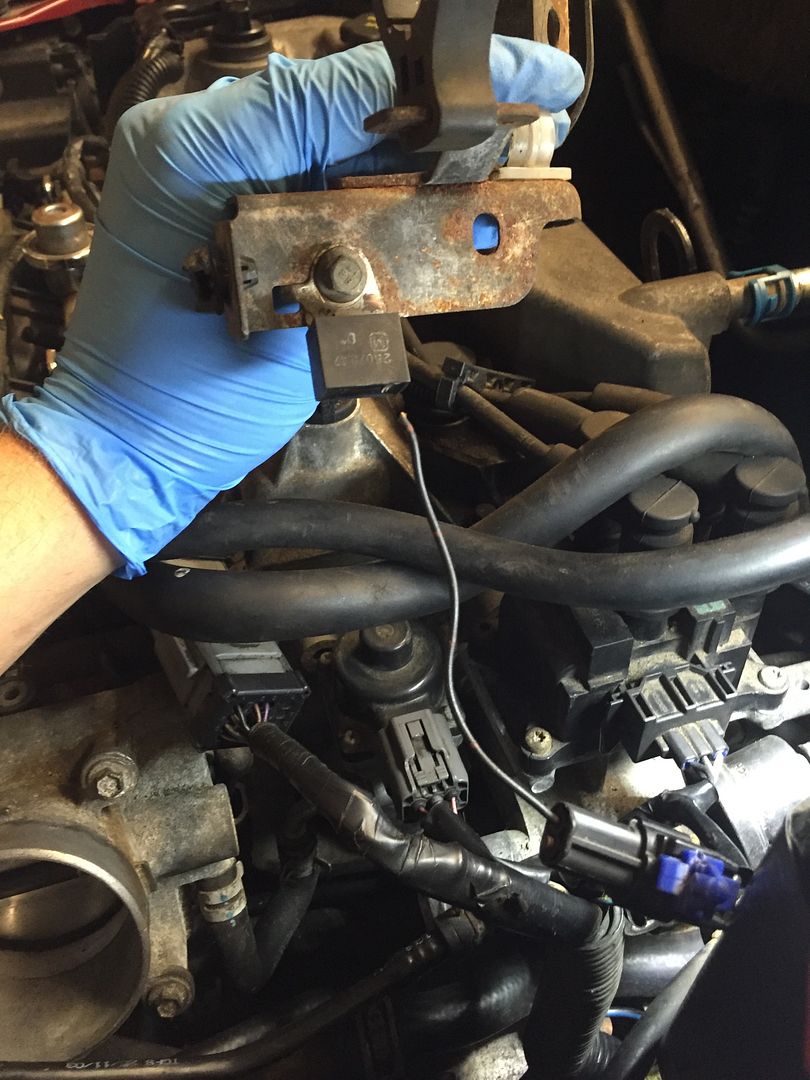

Here is the coil plug

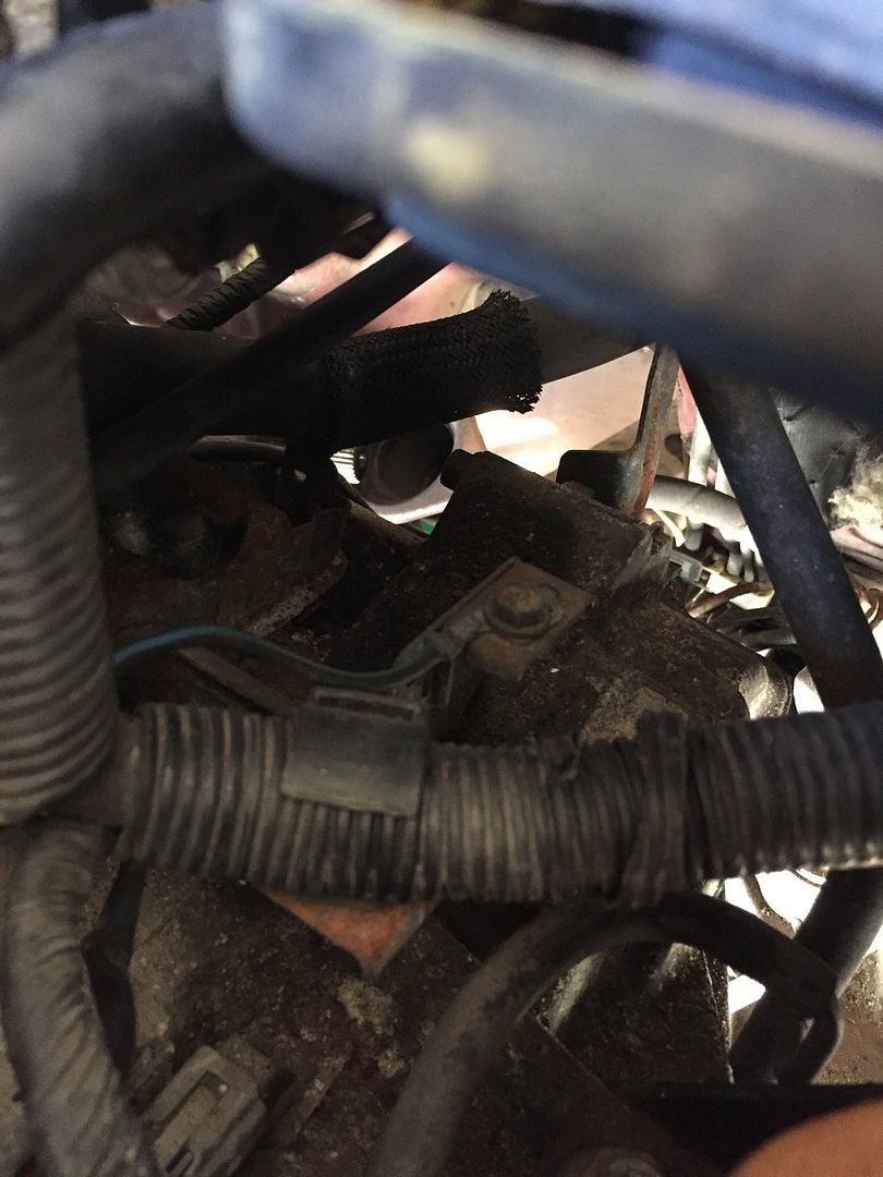

Here is the wire that I believe is the ground for the coil. I bolted it to the throttle body in this pic and then I realized that would probably not be a good test since the t/b is bolted to a plastic manifold.

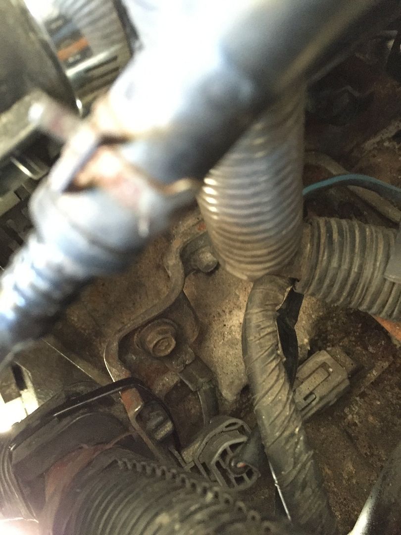

Here is one of the ground on the transaxle. It tested good, but I guess that will not rule out and actual broken wire.
This is the other ground on top of the transaxle that also tested good.

I changed out the crank and cam sensors...not change. Still no spark. The plugs do not smell like gas either so I assume they are not firing. I do have fuel pressure at the rail. One sensor that I did have to change out when I did the engine swap that is not really talked about is the one that bolts into the head next to the intake came closest to the timing cover. That plug got broken on the Fusion engine, so I swapped over the sensor from the mazda engine. They looked the same, but I thought I would throw it out there incase that is causing a problem.
Also, I checked the voltage at the coil while being cranked. When the key was switched on it showed about 12.5v (same as the battery). Then when cranking it drops down to about 10.5v. I am thinking this is not low enough for no spark, but again I thought I should throw it out.

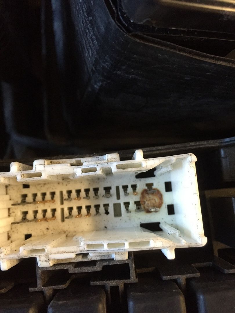

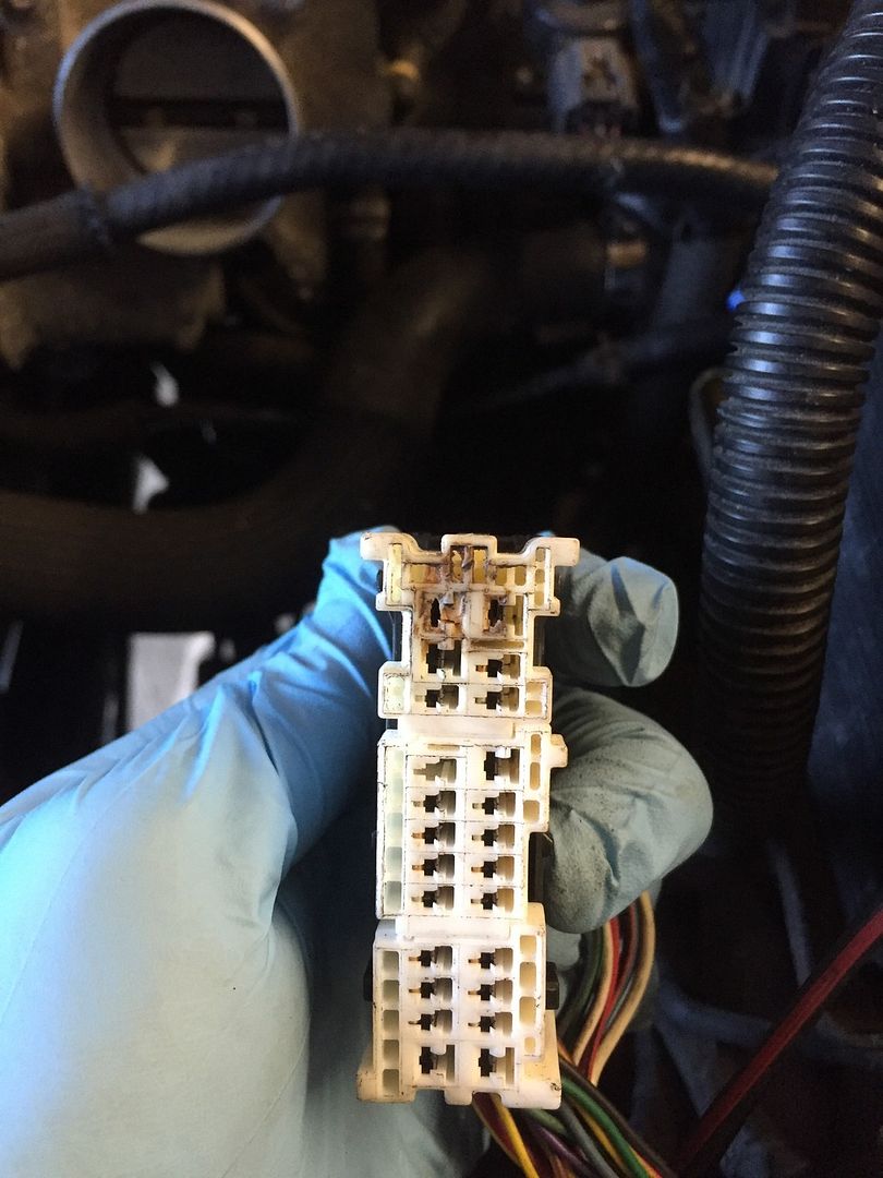

Does anyone know what the top two (closest to firewall) pins on the connector on the side of the engine bay fuse box are for? Mine look like there may be a problem. I am assuming this is not normal? Has anyone else unplugged this plug before? What is the best way to clean up the female side of the plug...contact cleaner?

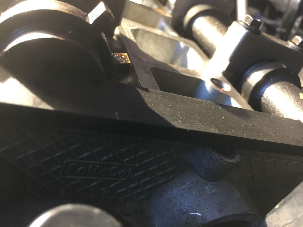

and then this picture shows my cam lock in what I believe to be cylinder 1 tdc. Please feel free to let me know if you think this is wrong.

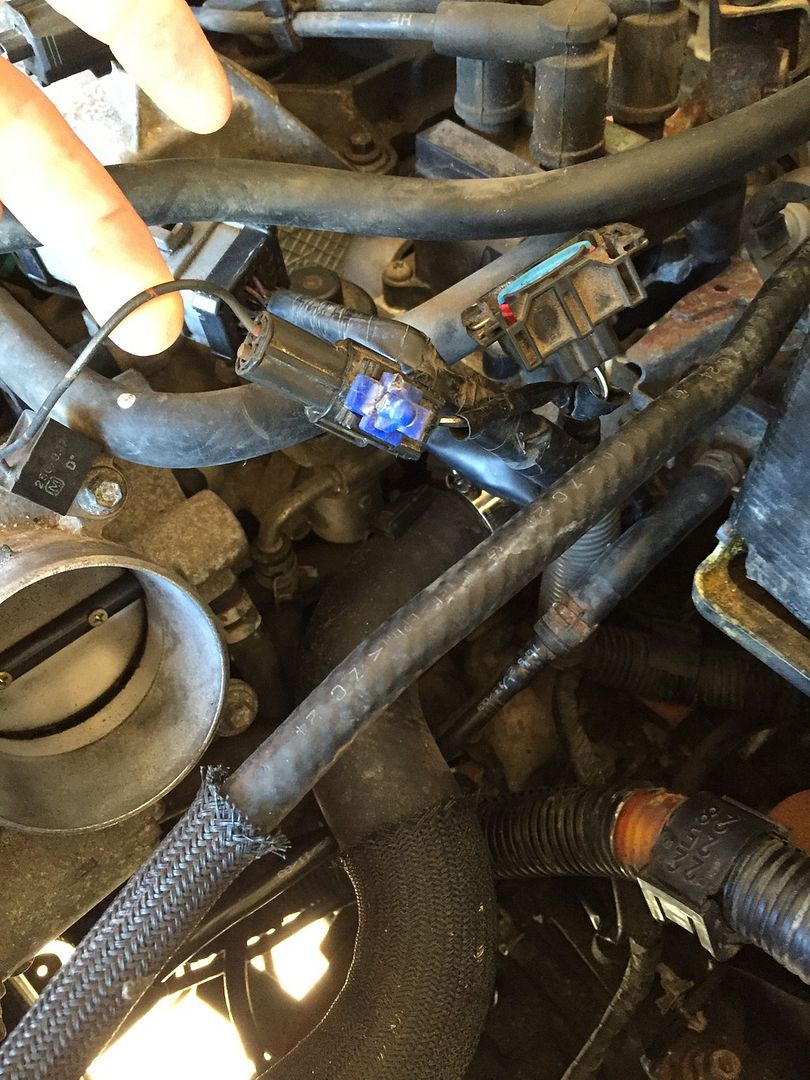

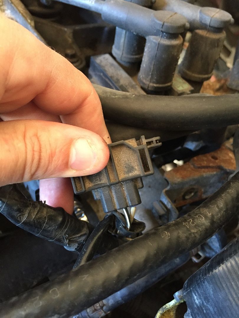

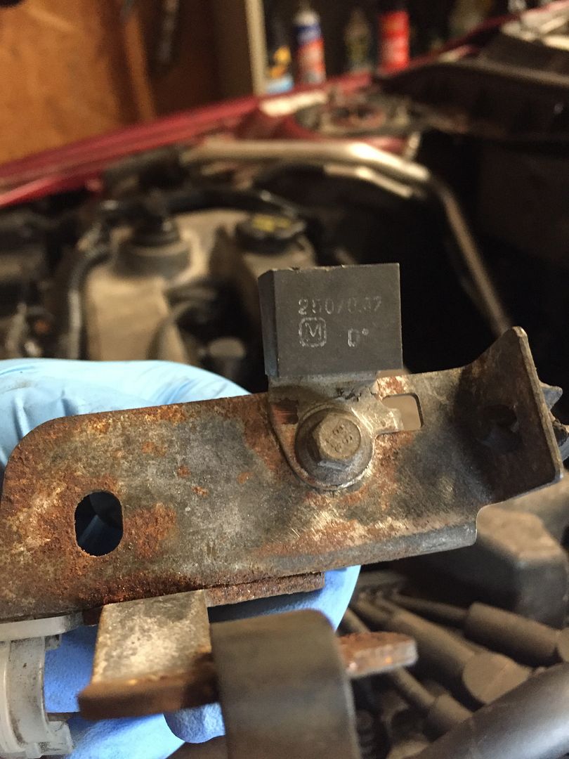

hey guys, back at this again. I pulled the timing cover back off and re set the timing...I don't think it was off before but I did it just incase. My Dad was hooking the engine back up and a few things got messed up along the way. I need to know what this is so I can order another one. I posted a picture of it bolted to my throttle body (that is not where it goes) on page one of this thread. It goes close to the ignition coil.
It is gel filled and used to have one wire coming out of it. The only thing I can read on it it is 250/.047 Not getting much from google on this one.
