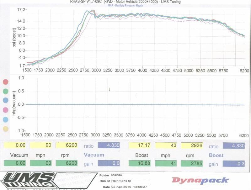

My mods since last dyno- 3.25" ETS, Synapse BPV, Upgraded from 2.5" TP to 3" TP, and CP-E Single exit 3" CBE.
I am very pleased with the gains throughout the entire band, i am even happier the runs were consistent. My run's back in May (2009) were VERY inconsistent due to heatsoak, thank you ETS! Lol.
Hopefully I can pickup an AP cheap here in the next few months (*cough Iheartgroceries *cough), get it tuned, and then dyno again!
Thick green line is new HP line/Thin green line is old HP line
Thick blue is new TQ line/Thin blue line is old TQ line
RPM- HP/TO gains
2500- 10/15
2750- 15/32
3000- 10/20
3250- 8/12
3500- 10/15
3750- 12/18
4000- 12/13
4250- 8/11
4500- 10/10
4750- 14/11
5000- 22/22
5250- 17/17
5500- 13/20
5750- 13/13
AF/R- need to lean it out a bit.
Hit 17.2 PSI
All 3 runs (blue, red, green) against previous May run (pink)
Looking at your AFR's compared to the OL/WOT targets for what will be your map (Stage2 TIHSF+TMIC.. same as stage2 TIHSF), your average AFR's look great in the upper upper rpms... not much room for leaning her out there imho. Also, you're a tiny bit lean in the mid-rpms, buy not by much. This was just eyeballing the middle of your AFR's. Take a look for yourself:

NP. I don't know why the pic came up so tiny. I remember with the old site if you had a large photo it would shrink it, but you could click on it to blow it up. It was just a screen shot of ATR, but I didn't check the size.
