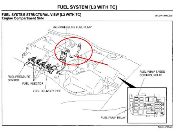

The fuel line under the hood started to leak last week from the connector. This is the fuel line (rubber hose) that connects the hard line from the fire wall to the fuel pump. There is a blue connector on it and it sits right above the rear heat shield and turbo. I need to replace this ASAP and wanted to know if anyone had a part number for it or know of where I can get my hands on one cheaper than dealer prices. Thanks!
When I get the car back to my place tonight I'll take pics so everyone can get a better idea.
Here is the page from the service manual...again still lacking a part number
