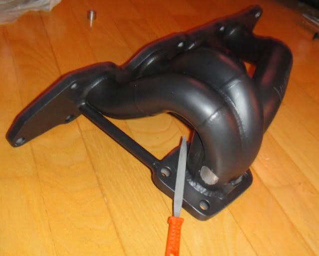

Filed by hand with a cheap file, ftw. I didn't have any of the tool you guys mentioned. I think I did a pretty good job of keeping the mani coating removal to a minimum. Took some time to get to keep it round and smooth, but it worked well:
