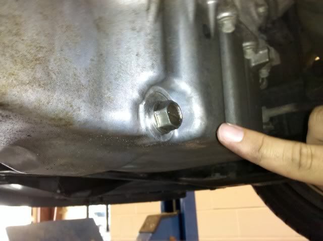

Use the 17mm socket to remove the oil drain plug with the container underneath. There's plenty of oil in there so it's going to be a while. Meanwhile, inspect the condition of the crush washer. If it looks in bad shape, it might be a good idea to replace it. Looks good? Reuse it!
Step 4:
When the oil rush comes down to a trickle, screw in the drain plug by hand and move the container under the oil filter. It's the black cylinder shaped object forward of the car

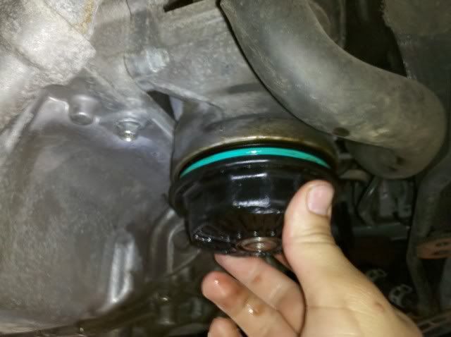

On the center of the oil filter cartridge, there's a recessed hex slot. With the 6mm Allen key, remove the plug to drain the oil out the filter itself. If you're lucky, the dealership hasn't stripped yours out like mine! :lol:
Step 6:

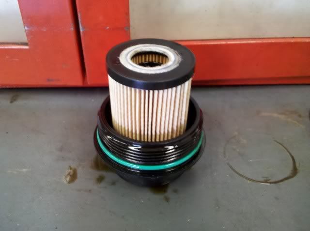

Once the oil from the filter is gone, use the oil filter wrench to remove the cartridge. After removal, slide out the old filter.
Step 7:

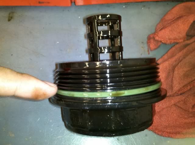

With the O-rings that came with the filter replace the 2 O-rings on the cartridge by removing them with a screwdriver or similar tool. I did it by hand since I'm good with my fingers. ;) The smaller O-ring goes on the filter drain plug (picture not shown). Lube them up really good. Some people skip this step, from what I've read and heard. I went ahead and replaced mine. Shit, they're new, right?
Step 8:
Slide in the new filter and screw the oil filter cartridge on, then tighten snugly.
Step 9:
