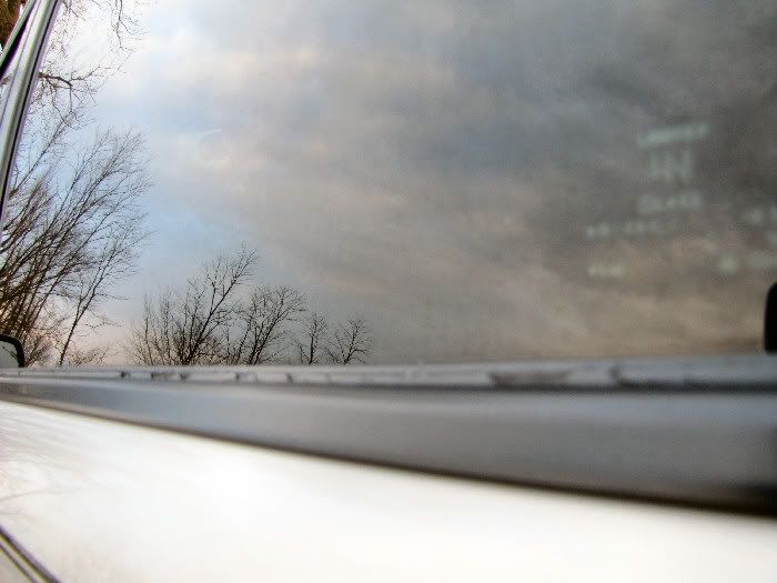

So we had this fast moving storm come through a few nights ago and it dropped marble size hail. Of course my 6 was sitting out in it...
The next day I took inventory on the top/hood and thought that I'd gotten lucky...no dents. Not so quick--today I noticed this damage to the window seals just on the side doors(all 4 side windows look the same pretty much)
Sorry the pics didn't come out as good as I hoped. The thin "lip" of the seal that laps onto the window must have been brittle but it looks like someone went along and just picked off chunks all along the window.
Is the replacement parts going to be expensive and is it something I can do myself. My wife doesn't want me to file an insurance claim for fear of my rates going up. Any suggestions?

The parts are dirt cheap, and they're brain-dead easy to install. Both of my rears cracked and it took all of 15 minutes to change them.
434 Posts
Discussion Starter · #10 ·
Any idea what they are called? I've been searching for a couple hours online and have no idea what to label it as. Window seals? Window channel weatherstripping? Can't find the right name for it.
3,744 Posts
Looks like 'belt moldings'.
