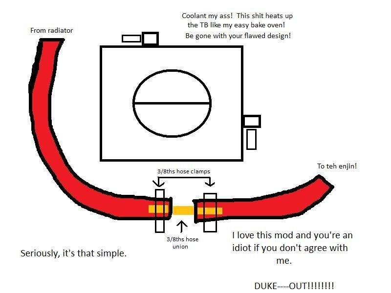

Throttle Body Coolant Bypass
What you'll need:

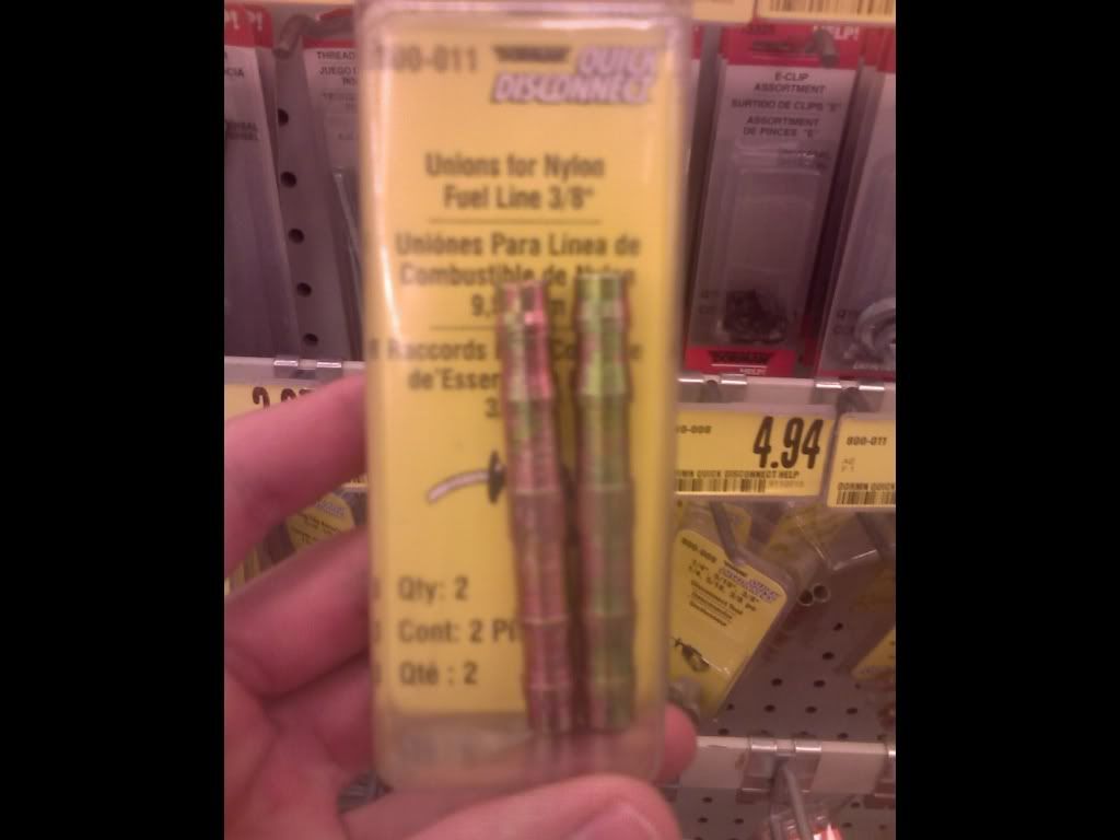

(1x) 3/8ths Hose union by Quick Disconnect
(2x) 3/8ths hose clamps

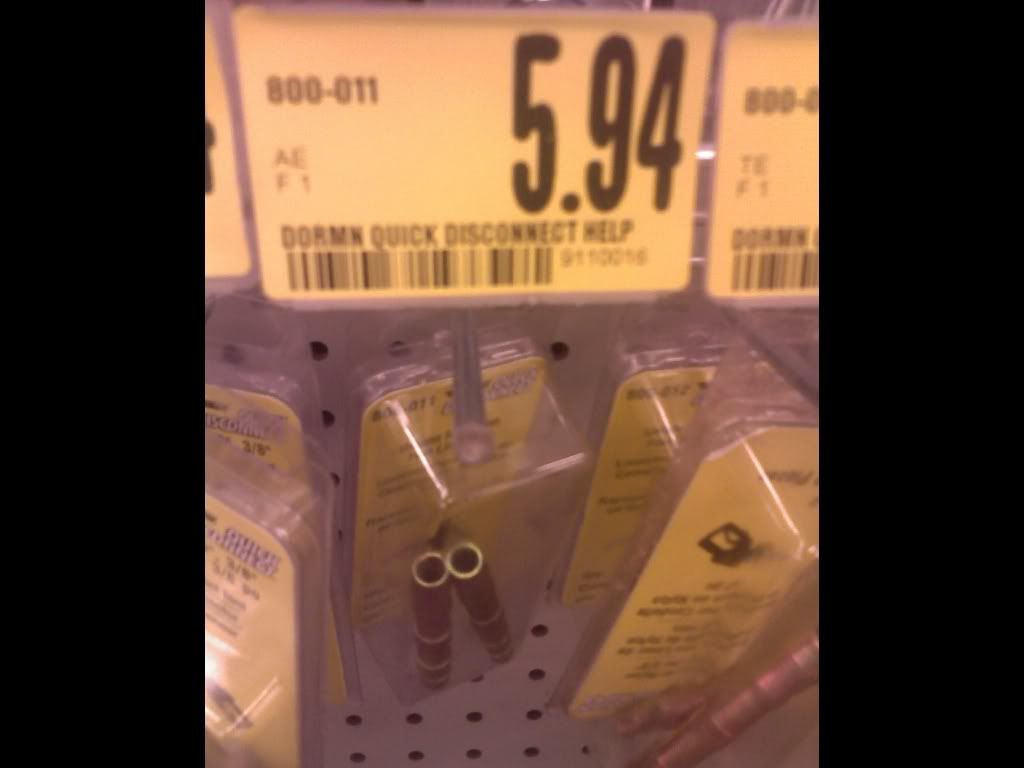

Hose unions are made by Quick Disconnect and are part number 800-011
Tools:
Needle Nose Pliers
An awesome screwdriver!
Some badass muscles of doom (maybe)
And then follow these steps:
So easy! It really helps a lot as the TB is a decent sized chunk of metal. Not having it heat up to a billion degrees not only helps underhood temperatures (errr, right?) but it'll make sure the TB isn't heating the air up before entering the engine and potentially robbing you of some power. What I like about it even more than that, however, is the fact that it won't bleed heat into/onto the intake pipe. Big difference on the temperature of the intake piping after being run hard.

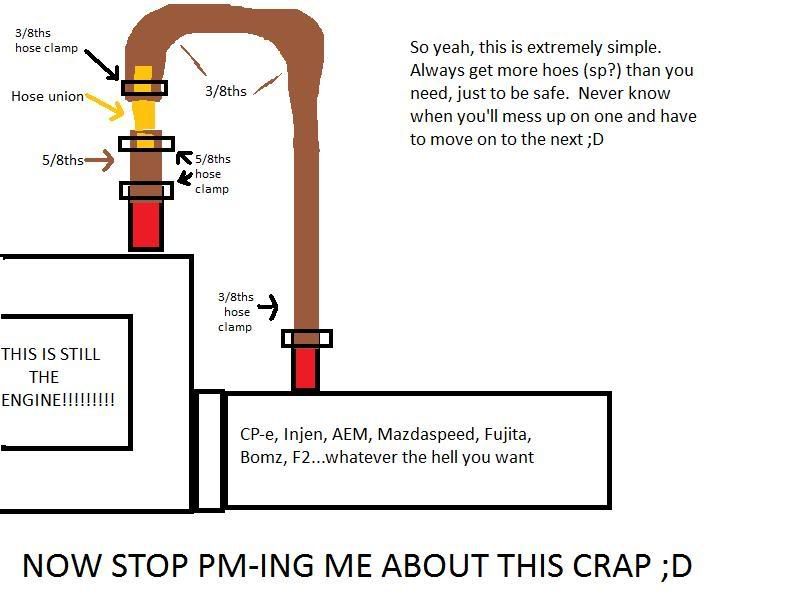

Intake Air Hose/Crank Case Thingie
What you'll need:
(2x) 3/8ths Hose clamps
(2x) 5/8ths Hose Clamps
(3ft) 3/8ths Hose
(1ft) 5/8ths Hose
Tools:
Your sexy self!
The oem black/light blue plastic piece on the crank case is a bitch. Just treat it like one and break it. Show how we 6 clubbers roll, ya know? Anyways, 1ft of 5/8ths is plenty, and 3ft has proven to be plenty as well, but no one is stopping you from purchasing more than that. I'd suggest it, actually, simply because you'll always need some new hose for a new project somewhere down the line. The quick disconnect hose unions come two to a pack and cost about $7 from what I can remember.
So basically, if you're getting an intake, you're probably going to have to do this crank case thingie but while you're at it, just go ahead and do the TB Coolant Bypass mod as well. It's well worth it, in my opinion.
What you'll need:
Tools:
Needle Nose Pliers
What you'll need:
(3ft) 3/8ths Hose
(1ft) 5/8ths Hose
Tools:
Your sexy self!
