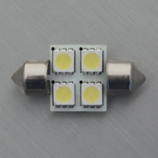

The bulbs that will fit in these sockets are 3175 "festoon" - Go here for links to the best sites to find them on.

NOTE: The Front and Rear lights, although the same bulb, have different housings. The Front housings are meant to hold SLIGHTLY smaller bulbs (maybe 29mm instead of 31mm 3175) but the 3175 still fit fine. The rears have no fit problems whatsoever.

I did mine yesterday. I would highly recommend changing over to LED bulbs.
Yeah most people love the LEDs - Personally I got the "Xenon" bulbs from Autolumination because I loved them in my reverse lights on the '04. They're blue bulbs but a very nice soft white lights. Honestly, I wish they were a TINY bit brighter (only 8w) but beggars can't be choosers.

So I did an LED festoon swap on my rear dome lights last night. As I was installing them, I was pushing it to get in the housing since the light boards are a little too big to be horizonal. Then the light flickered out suggesting a fuse was blown. I thought screw it and would fix in the morning.
I then went out to town and when I went to lock the doors, they wouldn't lock. I then had to use the "fob touch" method and depress the stuck brake to get it to turn on again. The CEL was lit I was worried something was seriously wrong. Took the car home since I wasn't going to leave it unlocked in the city.
Got around to checking the fuse box this morning.
Its in the box under the hood and was labeled "Room 15A". She was blown all right so I did a swap and the lights worked, the locks worked and the CEL was off. Funny how the Dome light fuse stopped me from locking the vehicle.
Now we know.

so were you able to use the LEDs in the rear dome again?

Thanks a lot for that ^. I was replacing interior lights last night and as I was on the last bulb (passenger door light), blew the fuse. I knew I had read your post earlier in the day and pulled it back up to identify the blown fuse. Your info was a lifesaver. All said and done, it looks amazing. Especially with the black interior!

I installed blue dome, map, and courtesy festoon LED's. Look great at night, will have to take night pics.
