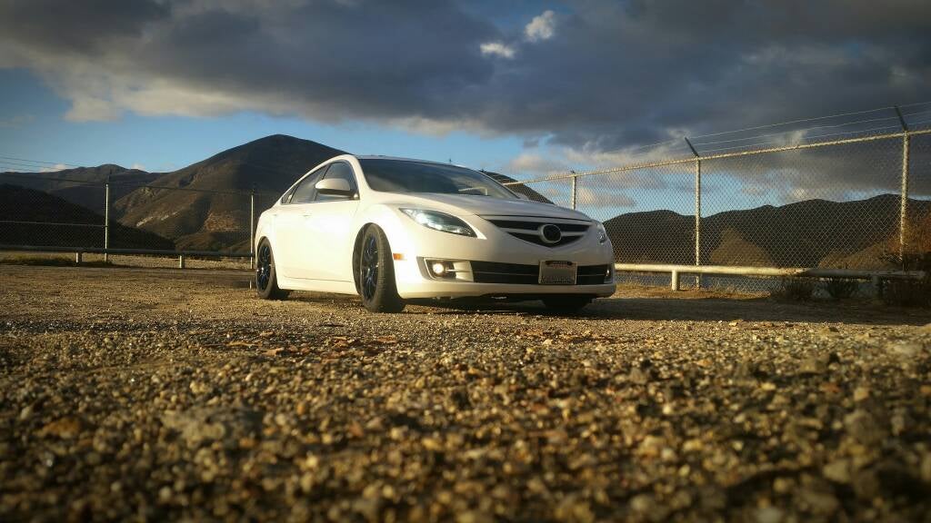

Update: Front lip, switchback LEDs, and another exhaust tip (to make it 2 instead of just 1) on the way. Will post pictures when installed.
105 Posts
Discussion Starter #7 (Edited)
So I installed my coils today, they're super low. I also got the front end fixed after almost 3 years. It's finally coming together. I'll post newer pictures soon.

Where did you get that front lip? Can't wait to see more shots with it slammed!
Reactions: Cyborg JSK
105 Posts
Discussion Starter #9 (Edited)
It's a lip for a gen coupe, I got it off of eBay from excess motors.

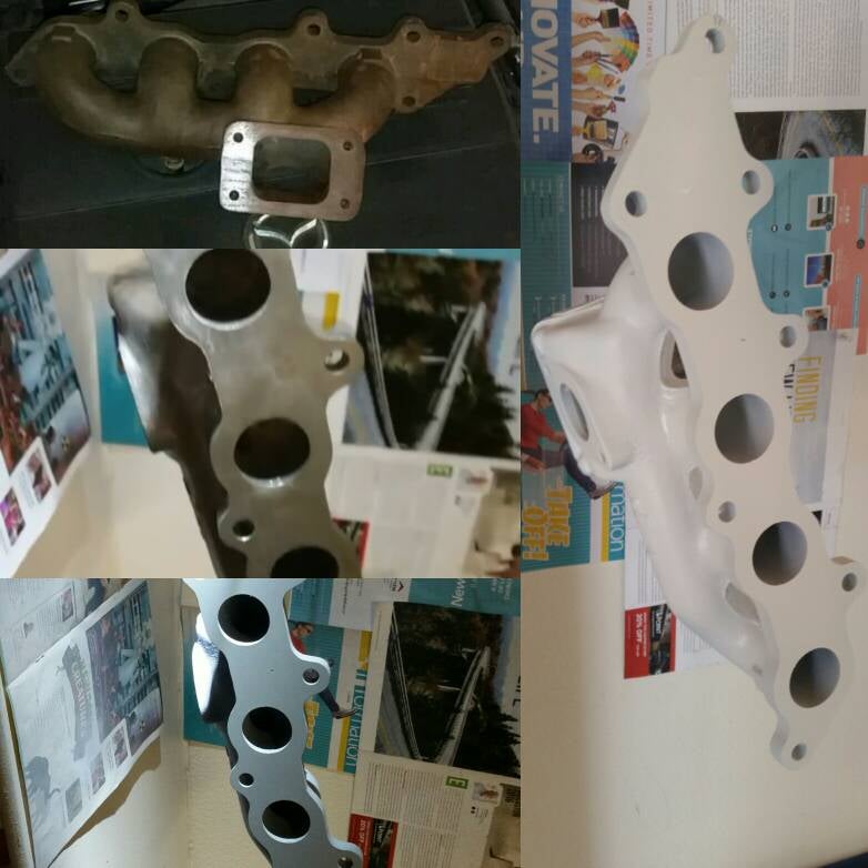

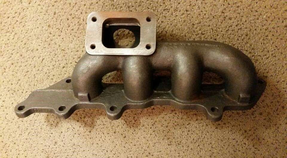

Quick update on my 6. Finally got the second exhaust tip put on, and deleted the resonator.
Painted my turbo manifold as well (I'm gonna put titanium wrap on it eventually). Next I will be buying all the gaskets and oil/coolant lines.
