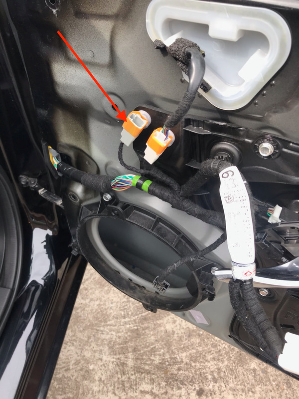

Pulling my hair out as I'm recovering from double hernia surgery last Tuesday. I'm only in week 1 out of 6 weeks recovery. Can't lift, drive or work so I'm trying to get myself familiar with the 6's wiring diagrams whilst I'm an invalid...
Plenty of time to read but am I thinking the impossible? It could be the copious amounts of codeine mixed with alcohol distorting my brain who knows. I have done some mad retrofits in the past like memory seats, columns, mirrors etc so not a stranger to pulling wires and taking stuff apart.
I'd like to retrofit the Blind Spot Monitoring System (BSM) and the Lane Departure Warning System. (LDWS) Not that I need it but more the fact it's missing both of those in my car.
I know I'd need to replace the cluster switch in it's entirety and also add the extra sensors on the windscreen/shield, both LH and RH exterior mirror glass and both BSM control modules
My car already has TCS, TPMS, i-stop and AFS so with the BSM and LDWS buttons the cluster switch would be fully populated which would be pretty neat.
I have a feeling some of the wiring might already be there. When I fixed my front door speakers a few months back I noticed a spare connector in both front doors. Would this be for the BSM or would this be for electrochroamatic mirror glass? (see picture below)
The car is a 2014 (oct) UK spec SportNAV. I think it's the same or very similar spec to the US GT.
If anyone has any insight into any of this it would be greatly appreciated.
I am not sure what the plugs are but I am pretty sure they are not for the BSM because I do have BSM and mine has those empty plugs too.

Ah that’s annoying. Wonder if they’re just for electrochromatic mirrors then.
How many wires has the ‘normal’ plug on yours?
Honestly I am not sure. I just remembered that the plug was there when I saw you post it lol.
