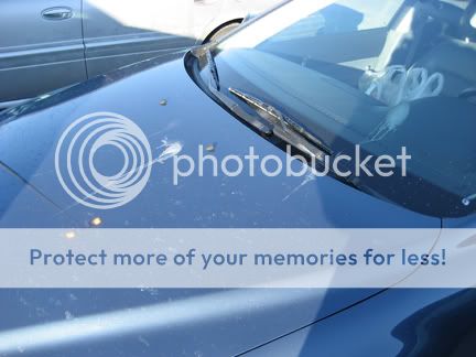

Are there any 6 owners out there who have to park in an open air parking ramp on a daily basis? If so, perhaps you have some experience with this or anybody that has had this happen to them. The photo is of some water spots that showed up on the hood of my 6 one day. I assumed it was from water that dripped from the upper level of the parking ramp. We just had a stretch of a few warms days here in Wisconsin so stuff started to melt and everybody's car gets that white winter salty/shitty grime on everything. Anyway, this stuff just looked like it had dripped over night and I didn't think much until I tried to wash it off. This stuff DOES NOT want to come off. I washed my carat a brushless place twice but that didn't work. Now some stuff dripped right on my windshield the other day and that too will not come off. Any ideas on how I can get it off? Am I wrong in thinking this is just some stubborn ass salt/water combo? I tried scraping the stuff on the windshield with my fingernail and it comes off but it is very difficult. IN all fairness I did all of this in cold temps.

I had that problem before. Try some vinegar on the deposits.

yeah it could be that the minerals have actually etched a spot in ur paint, in which case you would probably need to use a buffer to get it out. But try the vinegar first like rx7turbo suggested

Probably some oxydation/rust in that water from the parking garage. Claybar! Soon!!! Will etch the clearcoat. Wax the hell out of the car when you are finished.

I've always found that if you use something like Meguiar's Quik Detailer, usually produces pretty good results. Like everyone else is saying, once that's stuff off of there, make sure to claybar as soon as possible, use some paint cleaner after if you're still seeing any signs of your clearcoat or paint being distorted due to it, then wax it asap. Two thin coats will do wonders so you hopefully won't have this happen again. Good luck!

Use steam on the spot from a portable machine ask a friend for one,rent or (buy and return). In my case the bird sh##! comes out then Wax,WAx,WAX.

I know exactly what you mean. I use them at work a lot. Thanks for the advice. I just have to find a warm place to clean this stuff off with.

A lot of good suggestions. I will have to look into the steamer as well as the vinegar idea.

Sorry this maybe late, but I figure by now, you must have gotten all that stuff off. Once it is off, you should put a sealer wax on your finish, by doing that, the next time a bomb drops, can be rinsed off. I have an 04 6S and my finish still looks great! I park it outside during work by Metro train route. Definitely get lots of uv and rail dust. But because of the sealer, all this stuff comes off usually just driving home. I also put the sealer wax on my wife's CX-9 and my 3 friend's Speed3,05 6i. Not to mention an assorment of other cars like 944,2 Hondas, Corollas, Camry.
The sealer wax only last 6 mon but I extend that slightly longer by adding a quick detailer each time I wash the car (every other week).
265 Posts
A buddy of mine at work had this same issue a few weeks ago, and I was able to remove the spots w/ claybar, and then threw some wax on it. Be carefull where you park from now on, and check the ceiling for cracks and water marks. Also, typically the water drips by the beams the most, so try to avoid those if possible. Good Luck!

I just bought a Mazda 6 for my daughter. It had some white spots the right front door, and window. It wouldn't come off with washing, and even buffing with an random orbit buffer. I then tried a Mr. Clean Magic Sponge. It's amazing, the thing works like...Magic.
No I don't have stock in Mr. Clean, but the way this thing works, I should get some.
