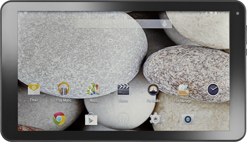

The Android Infotainment System (AIS) is using a 9" - 10" Android Tablet in our passenger cabin to provide basic Infotainment Features. I chose for this project the DigiLand 10.1" Quad-Core Tablet (16GB SSD / MicroSD Slot - up to 32GB Storage / 1024 x 600 Resolution / Wireless 802.11 B/G/N). It fits very well in the cavity...almost seamlessly:

To secure the tablet, so that it would not slide or fall, I used Tiny Self-Adhesive Black Hemispherical Rubber Bumpers and cut them in 1/2, and mounted them around the cavity at the base and sides, allowing me to slide it in and out without any major modifications:
