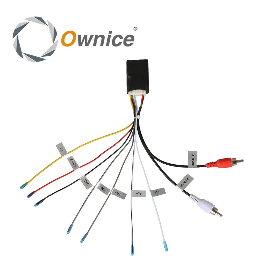

•ONLY DRAWBCK: Bose sound system Amplifier did not work. I know maybe I missed something during installation but I am still communicating the seller to know how to fix it. Alternatively, I connected Audio cables from the aftermarket head unit directly to the pre-amplifier cables and it worked (small Scratches).

By the way I ordered an adaptor from Ownice Shop to see if it can revive the factory amp but still the sound system is great even without the factory amp:
#Aliexpress QAR 127.37 | Car's Bose amplifier adapter to change the analog signal to voltage differential signal VDS

I have already received the adapter for the Bose system but I haven't installed it yet because of Coronavirus.. I don't let anyone touch the car. I will get it installed later. Once I get the result, I will update you all.
Attached a photo of the adapter I received Screenshot_2020-03-21-23-41-39-569_com.alibaba.aliexpresshd.jpg
