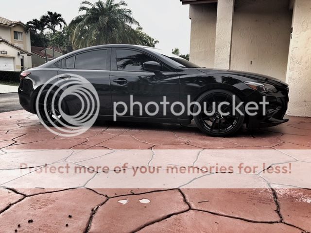

The stock offset for the 19inch rims is 45.
I’m running 19x8.5+54 wheels wrapped in 225/45/19 along with corksport springs/shocks.
I could have probably went with an offset if 35 but that would have been cutting it close! I can’t fit a finger between the tire and fender with ease.
